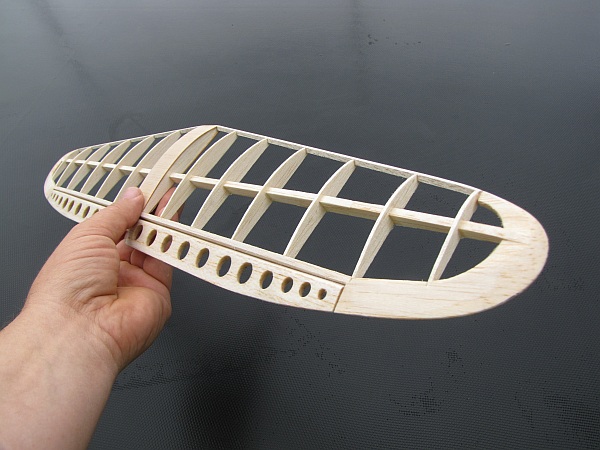

Photo above: I prepare CNC files for the wing parts and here I just tested (no gluing yet) how wing ribs fir into the slots of the trailing edge and wing spars.
Photo above: regardless that model is not finished yet and some wing parts holds just a masking tape together, it was time do the "photo session" of this beauty!

Today I sand the horizontal tail and now is ready for covering:
Bytheway, I accidentaly discover that wet elastic trampolin net is very interesting background for photohraphs, but one must be carefuil not to moist the balsa parts.
