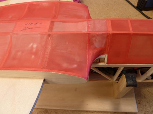

Maybe you know that I use for the most of my gliders a usual fabric, a lining fabric "Futterstoff". It's commenly used inside suits. Light and strong. This fabric is very useful to cover wings/gliders with it too.
Right now I'm trying to cover my "Stiegker" with a red lining fabric. Normally it's pretty easy to be varnished with dope "Spannlack". But these days it's somehow impossible. The whole coverage is full of white spots. What a Shocked [grrr] Since 2 days I was trying different sorts of dope and thinner. But still ... horrible.
To get another dope I drove to a local dealer and told him about these white spots on the cover. He recommended to use a special spray which should eliminate these spots.
AND IT DOES !!! [amen] -> see on the right side on the photo above: this section is already sprayed with this "spary magique"

You are right: this spray orginially "cleans white dust" on wood. It is especially made for "nitro-cellulose-varnish", like dope "Spannlack" or shellac "Schelllack" (sorry I don't know the right words).
I've tried it on my table varnished with shellac. Somebody put a hot or wet cup on it and then this stains come up. A quick spray with "spray magique" and these white foggy spots are gone.
Afterwards I've used it on my Stiegker. I am very very glad that this kind of spray has been invented.
