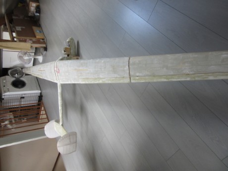

Just under a week ago, I found myself with a three-quarters completed Elefant (Ku4) in my attic. It took a moment to process, something like, what, where, how? But apparently I like that. I found the necessary information on Retroplane, Thomas had posted a beautiful set of photos on Retroplane, I'll include a few.
This (extreme) aircraft hasn't flown much, with a wingspan of 30 metres and weighing just under 500 kg, it's not exactly a handy structure, but that's less of an issue for the model. The Ku 4 or Elefant (it was heavy, big, grey and had two fins) broke up while flying in the clouds (with minimal instruments and virtually no flaps), but the pilot landed safely with a parachute. The plane was completely destroyed, in short, it surely was a daring project.
Then I sat down quietly in front of Raymond's construction, which was very neatly built and surely complicated! The tip ribs are really tiny, compliments to Raymond.
Where to start?
After studying the photos and the FMT drawing (which Raymond included), I first filed the nose cone into shape.
Then the front of the neck; the photos were different from the FMT drawing, so I made it a bit straighter. Inside the fuselage, I made some shelves with space for ballast, the receiver battery and the uncoupler servo.
I also made the core of the skate simple, using 8 mm balsa wood without suspension.
I put in the pilot, he realy had to sit that low.

I continued with the nose of the fuselage, glued 0.6 mm plywood on both sides of the skate and the lower planks of the fuselage.
Once the fuselage has been glassed (with 25 gram cloth) the skate itself will be attached.
The horizonral stabiloizer mounting plate with wooden spacers so that the tail will not crackwhen tightening the bolts.
Gradually, I got more familiar with the construction. I noticed that in the design (drawing of the FMT), the fairly thin tail boom was made of balsa wood. A strong nose, large wing and a stabiliser with two fins all connected with a balsa tube, combined with my landings, I was afraid that it would break quite easily. I therefore decided to make four “girders” from glass roving.
Using a specially made sanding block, I sanded four 5 x 1 mm grooves, which was good exercise for my muscles...
Pre-impregnated glass roving (four per groove) were anchored to sturdy points in the fuselage nose
This gave me a bit more peace of mind.

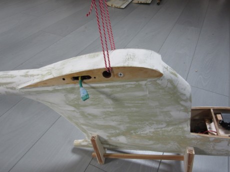

Wih the fins and rudders I had to make a choice. In the FMT drawings, the fins and rudders are flat plates constructed from balsa wood. On the 1:2 model and the original, they are fabric-covered structures
I decided, also in the hope of keeping it lighter, to build them from ribs. That was a challenge for me to draw in Devwing, but I managed it in the end,
Adri milled the ribs and TE in balsa and plywood
I planned to make the front spar from 3mm aluminium tubing, which is easy to bend, but the curved spruce spars were more difficult. I was able to bend them into the right curve using boiling water
and let them dry. To create a hinge, I used 1.5mm epoxy strips with 1.0 mm holes through which a 0.8 mm steel wire through it, so that the rudder remains removable.
The fin is attached to the stabiliser with two nylon M3 bolts, (on the photo they are from steel) removable for transport and so on.
The second rudder went a bit faster.
Both rudders in place,
Raymond built servos into the stabiliser, the control rods come under the stabiliser.
Unfortunately the fin and rudder are not much lighter than the ‘FMT’ rudders, but hopefully it looks better once they are sheeted with diacov and painted.

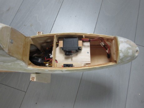

After sheeting the rudders with Diacov, I wanted to organise the nose of the fuselage with the battery and ballast. The battery didn't quite fit behind the nose block, so I placed it one frame backwards. Next to the battery, I added a switched power supply. I also made a charging and balancing cable so that the lifepo battery can remain in the fuselage.
The battery is held in place with a plywood board on which the servo for the coupling is mounted.
I can unscrew the 1.2 mm steel coupling wire from the servo lever, which is handy for inserting the ballast.

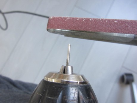

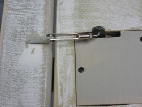

Moving on to the wings, I glued all the hinges in place with PVA. I made the coupling rods between the servo and rudders from pieces of M2 threaded rod with quick links on both sides.
There was not enough space for this with the ailerons. I put a stainless steel M2 threaded rod in a drill and used my power file to smooth the threaded rod and taper it to 1.5 mm.
I then bent it into a Z curve and it just fitted.
Now I could connect all the moving surfaces. I adjusted them mechanically to zero and then I adjusted the throws in my transmitter.
