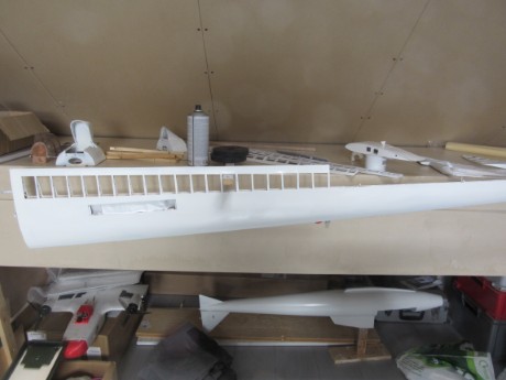

MessagePosté le: 04/03/2026 21:31    Sujet du message: Répondre en citant
Bonjour a tous,
Moving on to the wing. Given the choice of airfoil and the fact that the plywood is not varnished, I decided to sheet the top and bottom separately. First the bottom: I planed and sanded the LE into shape and repaired the vulnerable ribs here and there. To provide support for the glue clamps, I glued a 2x2 mm slat to the front of the ply .
I was now able to clamp the plywood securely to the LE and the rest with weights and clamps at the rear spars .
About the holes in the webbing; in hindsight, it would have been better to place the Bowden cable behind the main spar in its entirety and to turn the bellcrank around !
Where the aileron control is passing the webbing, I widened the spar, the webbing is complete,, not perfect, but acceptable,
I glued plywood webbing also to the rear spar and on both sides of the main spar..
Now it was time for the top sheeting. This was done in the same way as the bottom sheeting. The building supports at the rear of the ribs, together with weights, ensured that the wing was nice and flat.
After drying, the wing is very stiff and torsion-resistant. The front edge is nice and straight and the sheeting fits the ribs well .
Same planing and sanding to do!
Vincent (DB)

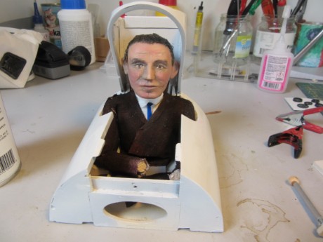

Vincent (DB)
MessagePosté le: 18/03/2026 17:58    Sujet du message: Répondre en citant
Hi Vincent,
Your driver’s got broad shoulders… stronger man Laughing
I can’t wait to see how you finish it off !
Âge: 80 Vierge Joyeux anniversaire !
MessagePosté le: 18/03/2026 19:07    Sujet du message: Répondre en citant
Hi Sebastian,
The pilot hasn't got broad shoulders, he will get a big head and the plane is very narrow!
He can just turn his head in the canopy MDR . The openings for his shoulders were cut out later, he got cramp!
Vincent (DB)

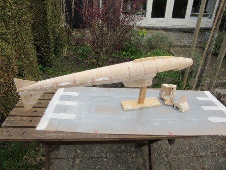

MessagePosté le: 12/04/2026 20:11    Sujet du message: Répondre en citant
Bonjour a tous,
Sanding and finishing, a tedious job, always reveals the imperfections, you start to see things you didn't see before....
I did make a kind of handle on the fuselage, so that it could be sprayed in 1 go.
To do something else than sanding and spraying, I made a partial pilot, partial because of the battery box. His shoulders should really protrude beyond the fuselage! A balsa puppet with “clothes” glued on and a head that I had left over from another glider.
All components are now ready for putting the Diacov on.
Vincent (DB)

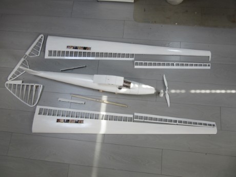

MessagePosté le: 18/04/2026 18:11    Sujet du message: Répondre en citant
Bonjour a tous,
Sheeting with Diacov (that I had lying around) was done quickly, I had just enough.
Setting up the transmitter also went smoothly.
I had calculated the CG with E calc and I had to add between 50 and 150gr of lead in the nose. I don't want to start the first flight with the most rearward (calculated) CG. I was able to make a hole in that former next to the battery box (left in the photo) and glued 50gr of lead in it.
Then I could close up another 100 gr lead, so that I can make the first flight with a forward CG.
In this photo it is clear that the tip is wider than the original.
He is ready to fly, now waiting for a good opportunity. ..
Some numbers;
Wingspan is 315cm, weight 2500gr
CG is 7.4 -8.4 cm from the LE. Total wing surface is 52.82 dm2, complete weight is 2500 gr, that gives a wingload of 47.4gr dm2
Vincent (DB)
