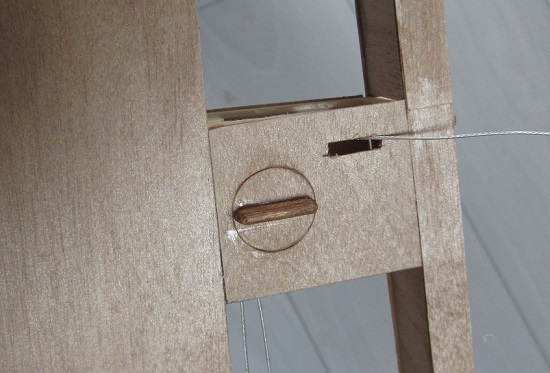

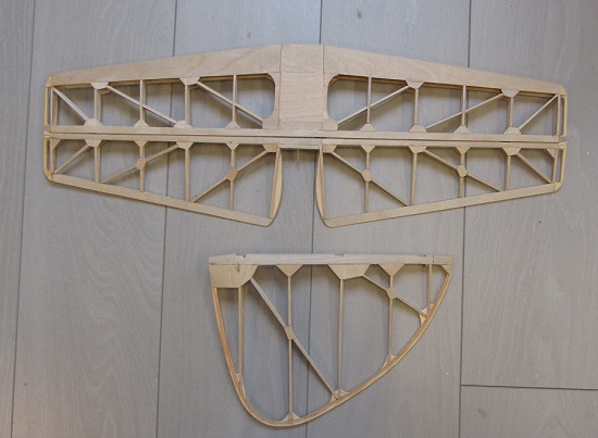

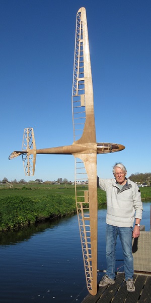

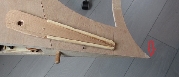

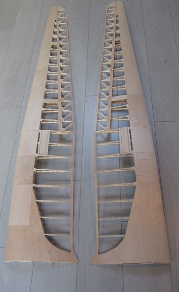

Hello everyone,
Thanks for your remarks Harold, I agree with you, the "gull wing" gives it indeed an elegant look. I found another nice picture of the real thing Very Happy

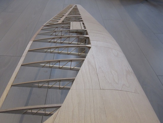

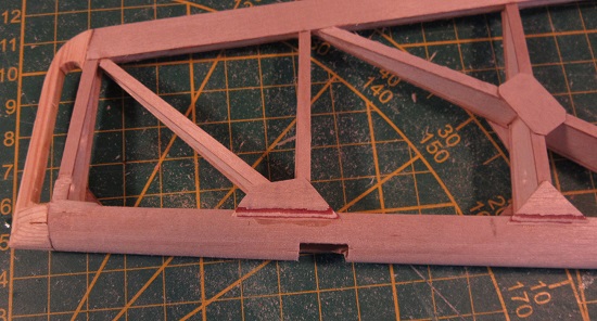

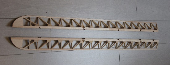

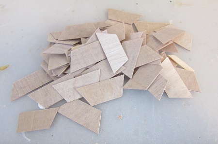

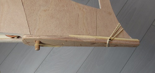

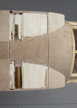

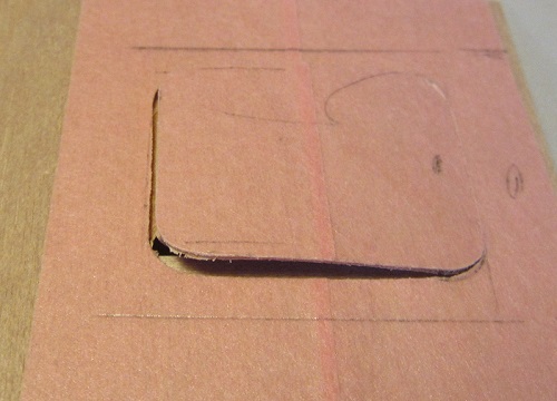

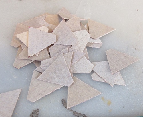

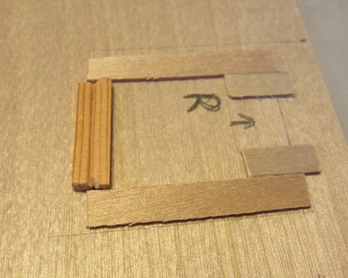

I went on with the wings, the capstrips and gusset plates had to be put on, a lot again!

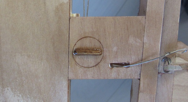

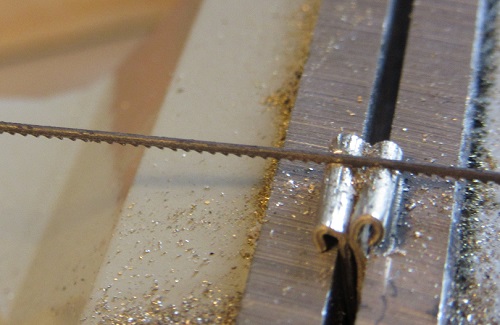

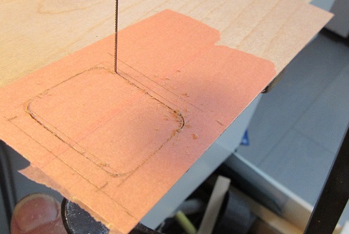

To keep the ailerons demountable, I had to keep the kwiklinks (or is it quicklinks Confused ) accessible, a hatch was needed.

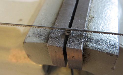

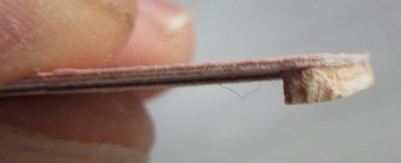

I used a metal piercing saw with tape against splintering
By bending the 0.6mm ply and a bevel? at one side it locks. Its possible to bend it through a hole in the root rib.

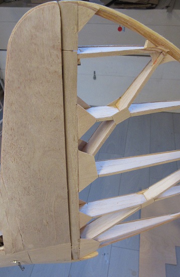

I didn't like the gusset plates at the elevator, I glued them on top of the D box as it should be, but I couldn't get the bevelling properly, it was distracting also.
So I decided to make them flush.

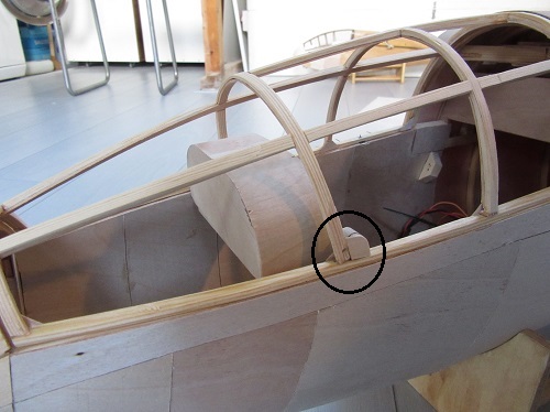

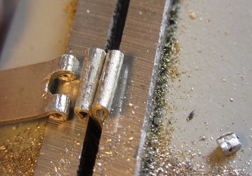

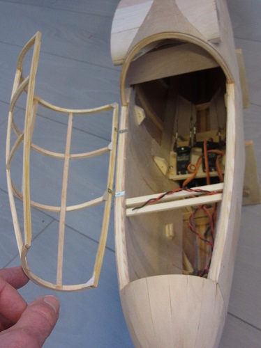

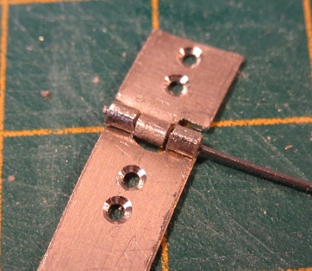

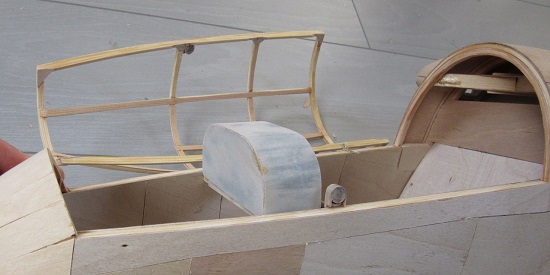

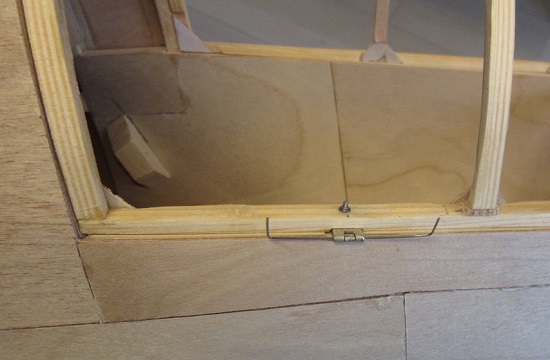

After this two day effort of cutting and gluing I made the hinges for the canopy, Folded a strip of nickel silver (big pliers Very Happy )
and fitted the canopy (still demountable, the hinge pins are temporary)
The canopy looks to small, it gets wooden battens at the outside after fitting the glass.

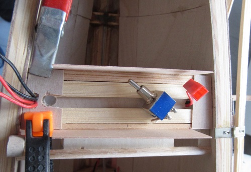

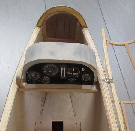

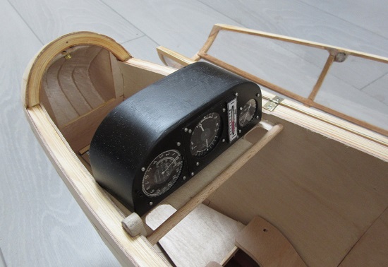

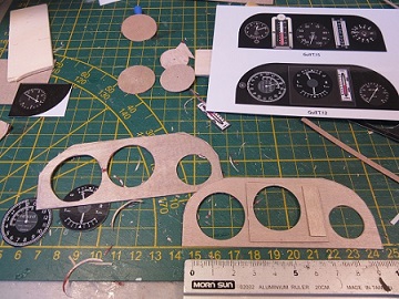

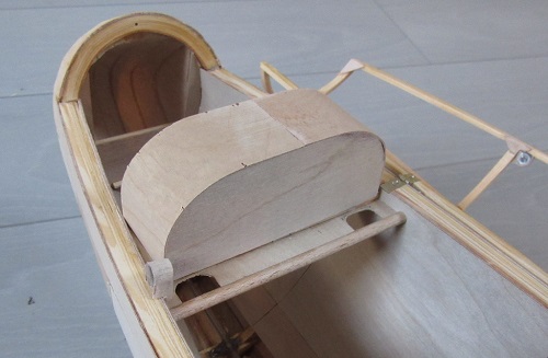

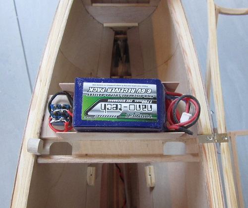

I had some problems to solve int he cockpit. It was hard to get the info, here in the museum in Edenburgh, the Gull hanging at the ceiling and dufficult to get by!
There is a kind of platform under the instrument panel
I also wanted to have my receiverpack and switch in it.
It was not easy to fit all in it, I had to remake it a couple of times
The instrument panel itself will be black, the ply I used chipped quite easily, luckily it will be painted.

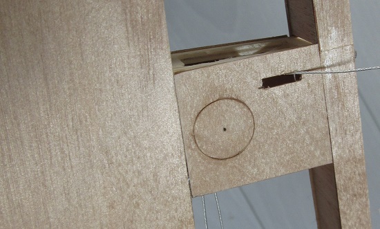

In the circle is a strong magnet lock (covered with ply) to hold the canopy shut..

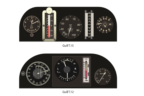

On the Scale soaring UK site I found this picture of the Petrel intstrument panel, which looks identical to that of the Gull in my view.
I ordered the instruments at Aerocockpit, maybe I use the dials from this picture.

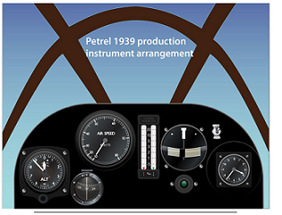

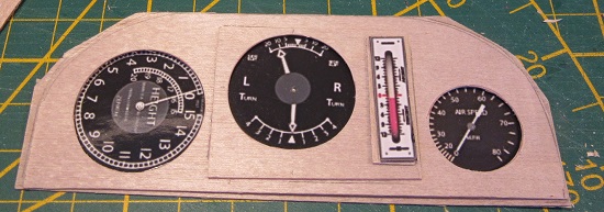

Thanks to Pat', I contacted Vince Cocket and he send me the layout of the instrument panel of the Gull T.12 and T.15

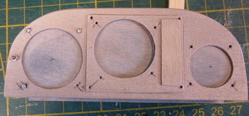

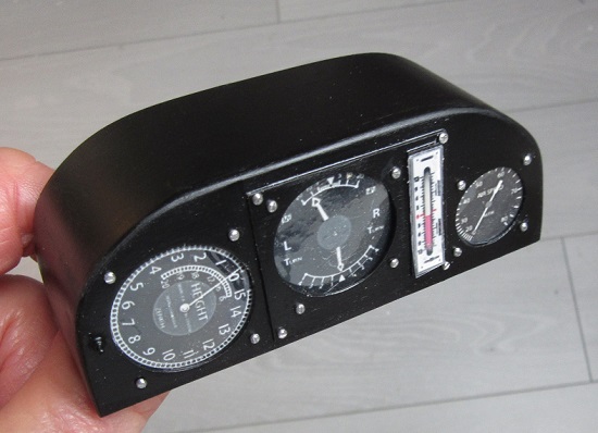

Because I modelled the T.12 (the one with struts) I choosed the lower image. Nice detail; the altimeter is turned 90 degr Very Happy. There seems hardly any bezels to be, so I tried to make it more or less flush

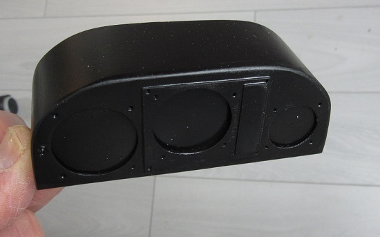

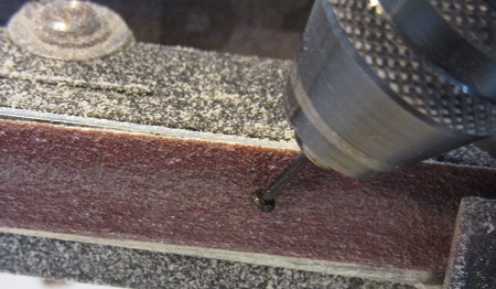

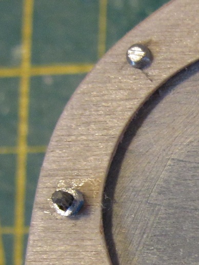

I thought there most have been machine screws to fasten the instruments and I didn't have them that small, so I modified some pins
first sanded the head and then I made a small sawcut
Now it gives (hopefully) the impression of screw heads
After its sprayed black the dials with glazing can slide in from the bottom

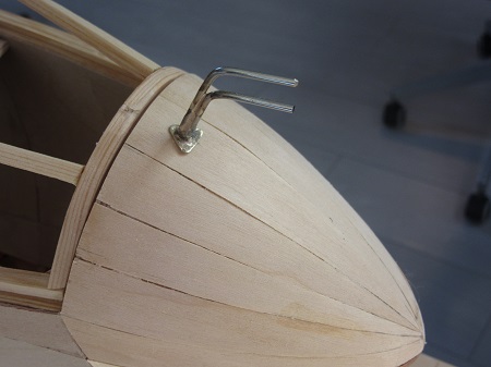

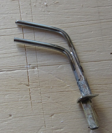

Another detail is the pitot tube, on the Scale Soaring UK site I found a nice picture of a number of pitot tubes
combined with a photo of the Gull
I made this from solid metal bar, silver soldered is a square braas tube.
Because its is vulnerable in transport I made it detachable, sliding in a bigger square brass tube in the nose and secured with a small magnet

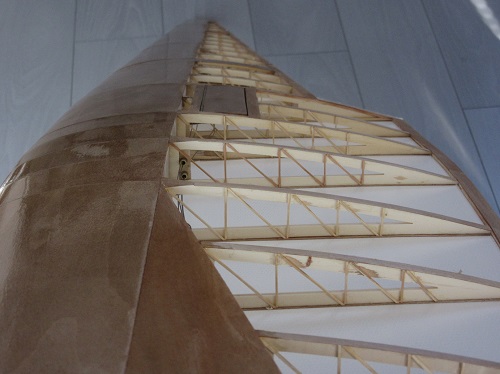

Talking about vulnerability, I discovered (you can see the repair...) that the wing root TE was also a weak spot
and I made a rather crude protecting device
All the capstrips on the ailerons were fitted and I also made a washout of 4mm at the tip of the ailerons
I replaced two panels with some chipping

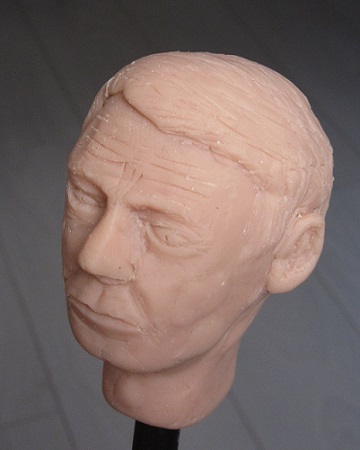

and finally I sculped the pilots head, again helped enormously by the tutorial of Josh Foreman
https://www.youtube.com/watch?v=WlPYWe2bGUo
Material I use (thats Vincent Becancon idea) is Super Sculpey Living Doll, a kind of polymere clay that can be baked in a oven at 140 degr for about 30mins (instructions are on the package)
The head is basically made on a wooden stick with a clump of aluminium foil to get a reasonably thickness (les than about 10mm)of the material. After baking I pulled the stick out and milled the head further out, to reduce the weight, its now 89 grams.
My sister is making its clothes and cap, so I am curious how he will look!

I sprayed the instrument panel satin black
very black...
I didn't glue the ply at the bottom, so I could slid the cut out dials in. On top of the dials I put a disc from about 0.3mm clear plastic sheet as glazing. Finally I glued the "screws" in place.

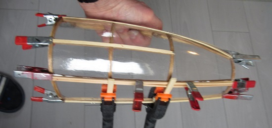

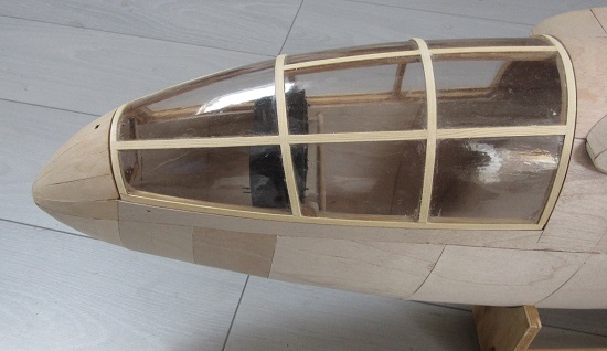

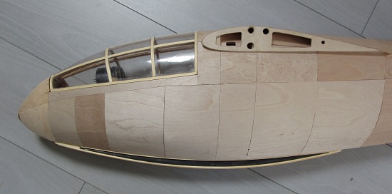

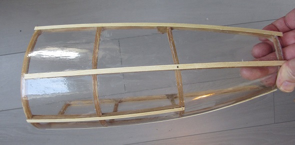

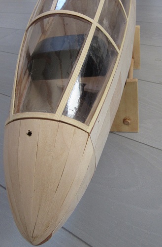

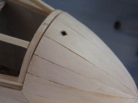

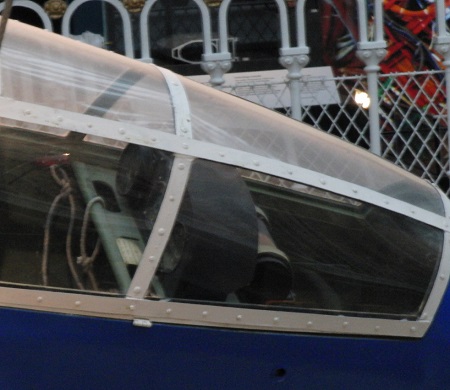

Next the glazing of the canopy. The real Gull has wooden strips also on the outside.

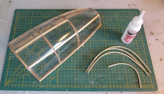

I started with staining the frame of the canopy. I choose to do that with bister (an organic material I bought in artist shop). I cut the canopy glazing in three parts which I glued on the frame with 'canopy glue'. After drying I glued strips (0.5 X 5mm spruce) lenghtwise
not easy, its slippery Sad . I cut slots in these strips and glued brebent strips across
excuse that the picture is blurred but it was the only shot of the gluiing, short of hands...
After a lot of fiddling it fitted reasonably flush with the rest of the fuselage.
the instrument panel in its place

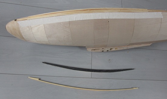

The fuselage still needed its skid, I decided to make a rigid one.
Laminated 3 layers of 4mm balsa, painted dirty black and the skid itself from 2 layers of 3mm spruce
two small battens to keep "the canvas" in its place are already glued on the bottom of the fuselage.

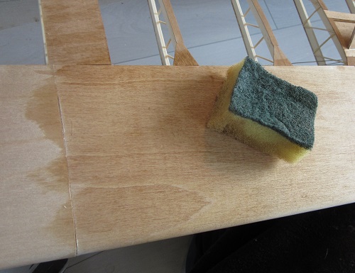

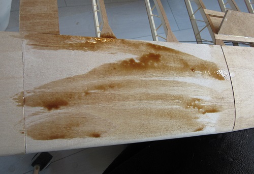

It was time to finish the ply. I hesitated which colour I would choose. In the end I decided to make a fairly light staining, making the Gull how it should have looked leaving the factory.
So I used bister, (Francais; bistre) the same stuff as on my Nemere 1/6. It is an organic pigment (a powder) with only water added. Rembrandt used it, I bought it in an artist shop. I diluted it quite a lot, till I got the right staining ( I hope....)
I put it on with a brush and
because its practically only water it had to be spread with a sponge

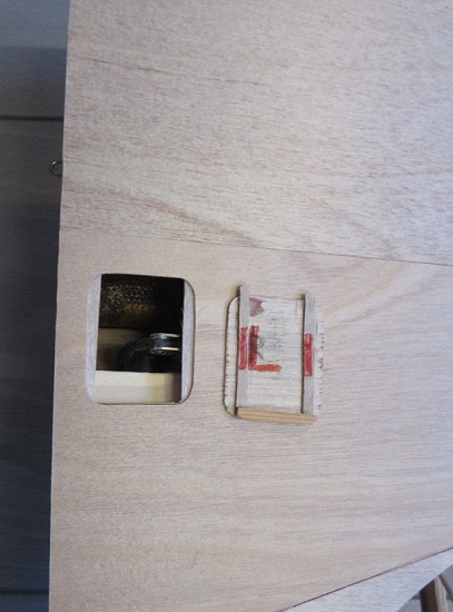

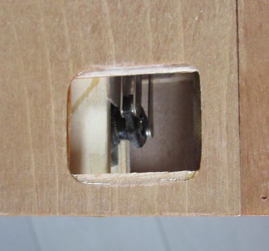

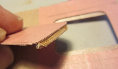

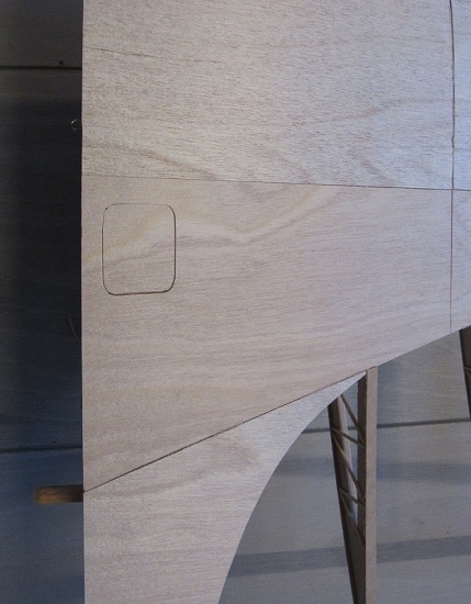

A small detail; I made the impression of inspection hatches with a rotating cutter, just in the outer layer of the ply (after glueing 3mm balsa behind the ply), stained it so the scraped circle became very visible
and than glued the "handle" on the hatch
I put on two layers of "porienfuller" (did this job outside) and after some sanding one layer PU boatvarnish
Put it together
I had the sun straight in my face...

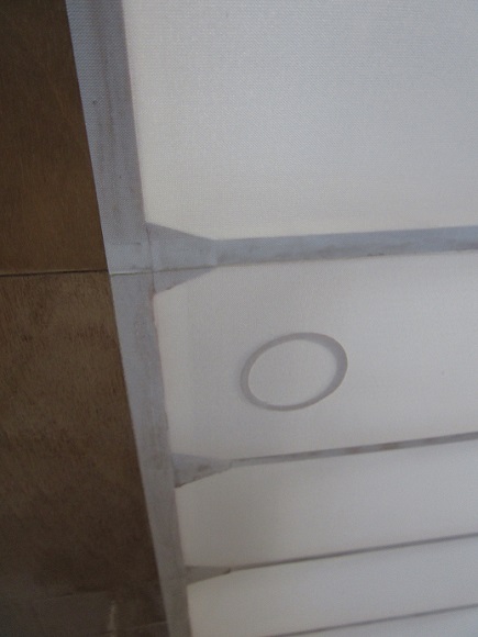

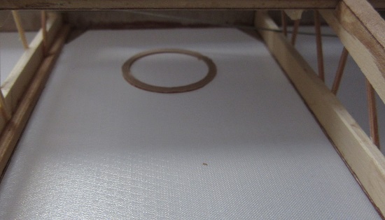

After the varnish I put on the Diacov
and put on a ply ring, just as a dummy inspection opening for the spoiler
Then varnished the Diacov and had a bit mixed feelings about that, some less good varnishing at the bottom, not possible to change it Embarassed

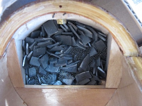

Now I could put the CG alright and I had to put in more lead than I had hoped.
700 gr, making 950 gr lead in total. poured in 24h epoxy, so it became a rigid block.
Reason for so much weight was perhaps the weight of the tailplane (145gr). Total weight of the plane is 5200 gr with struts (2 X 10mm carbon wingjoiners) giving a wing load of about 55gr/dm2 and 5600 gr without struts (2 x 10mm steel wingjoiners) giving a wingload of about 59gr/dm2.

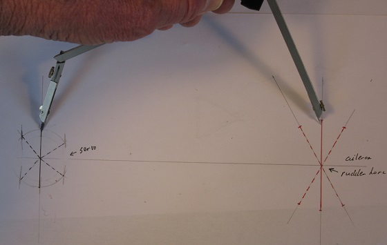

After fitting the receiver and programming the transmitter I discovered a nasty problem Sad , the ailerons didn't come well in their neutral position.
How did that come? To avoid problems with the steering cables I made the servo arm exactly as long as the rudderhorns. Because there was some friction in the pulleys and the servo arm was long , it didn't centre properly. What to do? I discussed it (at 1.5meter distance) with my friend Adri (from the anemometre on the Fokker) who had an identical problem already solved. He made a angled servo arm. I made a crude drawing and with a compass I constructed the angle on the servo arm, sorry, its analog MDR . In this drawing the servo arm is half of the aileron arm
second drawing at 30 degr
I converted this angle om a circular servo arm and had to drill an extra hole

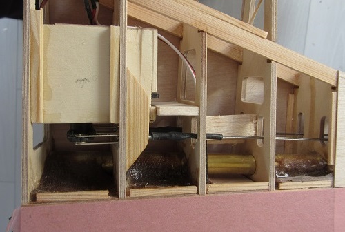

To my relief I had made an inspection opening in the bottom of the wing root, so I could change the servo arm and adjust the steering cables.
To my big relief the ailerons worked nicely and returned now to their neutral position Very Happy
To be continued,
Vincent (DB)
