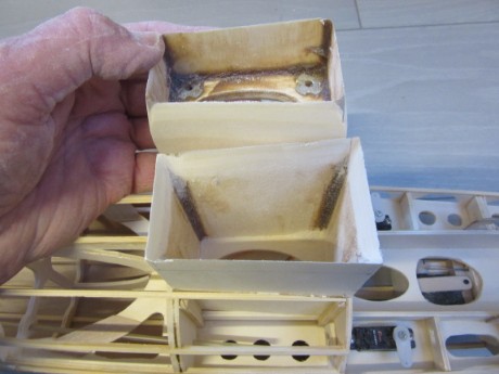

In the pylon, I thickened the plywood and inserted four insert nuts, to which the wing centre section will be attached with (nylon?) shear bolts.
Because the battery box also rests on the centerline, I was able to assemble it separately from the building frame. That went very smoothly, as did the holes for the servos and a small board under the battery box for the decoupling servo, so it must be able to be towed.

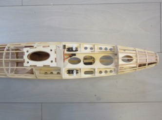

I went on with the fuselage, the two stringers on sides are on the construction level so on the 10 x 10 mm slats. With these stringers in place and the center of the formers on the centerline, I can secure the formers with clamps. I can check the outside nicely
I had to leave out the two front 10 x10 due to lack of space, but with a engeneer square on the building board I could straighten them out nicely
Next the cut-through formers, with a chisel I removed the temporary battens, and then I was able to detach the detachable fuselage pieces.
Of course they were still glued here and there. Some minor damage on a former
The motor fitted nicely, the leads and the controller were a puzzle. I could just put the controller on the side, I want to keep the battery box free, so that I can get the cg right with the battery. Of course everything has to remain detachable
I made two dowel pins and lugs for the back part of the detacheble fuselage piece
To make the nose firm, I also glued 0.6mm plywood on the inside. That will then form a nice sturdy construction with the plywood on the outside.

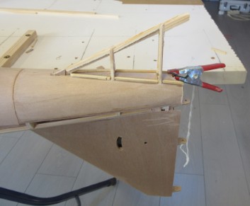

With the necessary fidgeting I was able to glue the fin and trusses for the skeg in the tail.

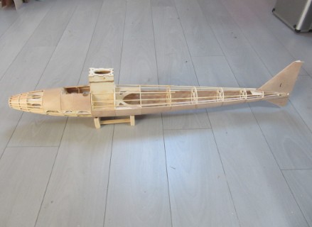

The fuselage is now making good progress and weighs about 400 gr. It still looks like a submarine...

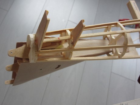

To make the skeg, I had to sheet the fuselage, but I also had to make the control rods. With the the control rods, I couldn’t replace the fuselage on the building jig…… So first the sheeting the bottom, then the skeg and the control cables later.
So first, the skeg, had to take some pieces of the frames away
The advantage of building on a horizontal jig is that the fuselage can be put on and taken off. To sheet the tail (the nose is already dimensionally stable due to its internal structure), I slid the fuselage back onto the jig. The fuselage rests stable there, and now I can sheet the bottom. After fitting a piece of 0.6mm plywood to size, I scarfed the edges

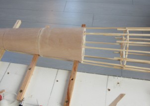

The rear end of the tail was quite narrow, I bent the rear pieces under boiling water and let them dry rolled up, put a rubber band around it and let it dry
How far you can bend it; see https://youtu.be/KoZUbuMlBck.
I glued the plywood with PVA and because the fuselage is open at the top I could clamp it to the stringers

Unfortunately, I couldn't get it super smooth, that had to be sanded, I wasn't very happy with that. Fortunately, all the wood is painted, not clear varnished, that gives me a lot more freedom, but still....
Fortunately, it does feel light.
Then back to the neck and cockpit. The Hjordis drawings are actually sketches. By the way, a lot of details were solved in the workshop of Slingsby.
The full-size wing was much thicker than the one on the model. Fortunately, the profile was chosen (see Merijn's post). After some initial thinking, I managed to sketch the cockpit and the wing neck. Finally, I based my work on the angle of the front of the cockpit, which I felt was crucial for the appearance.
Then it turned out the neck was still too long; I still needed to trim off another 15mm, grumble. Cut it off, scarfed and glued it with thickened epoxy. The angle of the wing to the centerline, is 9 degrees, which seemed like a good compromise to me.
Now I could create the transition from the cockpit canopy to the fuselage and the wing with a laminated spar (which will be discussed later).
This finished, I also could make the fairing around the neck.
An extra frame some and slats for the streamling of the neck.
This is how it looks now.
A try out with a piece of cardboard instead of the "glass" to check if all is aligned.

The fuselage now weighs 625 grams, excluding the three servos.

Now I was able to assemble the Hjordis for the first time, unfortunately because of the weather inside.
it's starting to look like a sailplane!
