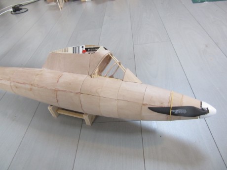

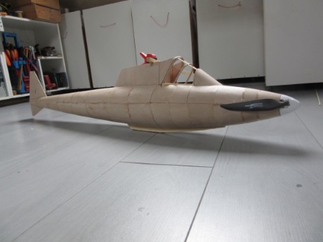

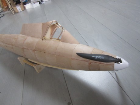

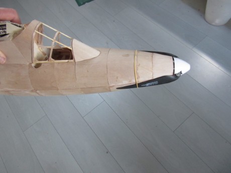

MessagePosté le: 09/01/2026 11:49    Sujet du message: Répondre en citant
Bonjour a tous,
Now I had to sheet the upper half. I found that quite difficult, especially applying pressure on the glue. Finally, with a few drops of cyano, I glued 3 X 3 slats onto a prepared panel
I spread PVA on the stringers and frames, except for the horizontal stringer where the bottom panel was already glued to. There I put cyano on the edge of the panel. This way I could press it nicely in place
until the cyano was set. It then looks like this
I cut off the slats later. I did the entire fuselage in the same way.
Unfortunately, I couldn't get it super smooth, that had to be sanded, I wasn't very happy with that. Fortunately, all the wood is painted, not clear varnished, that gives me a lot more freedom, but still....
Fortunately, it does feel light.

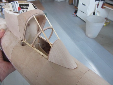

Then back to the neck and cockpit. The Hjordis drawings are actually sketches. By the way, a lot of details were solved in the workshop of Slingsby.
The full-size wing was much thicker than the one on the model. Fortunately, the profile was chosen (see Merijn's post). After some initial thinking, I managed to sketch the cockpit and the wing neck. Finally, I based my work on the angle of the front of the cockpit, which I felt was crucial for the appearance.
Then it turned out the neck was still too long; I still needed to trim off another 15mm, grumble. Cut it off, scarfed and glued it with thickened epoxy. The angle of the wing to the centerline, is 9 degrees, which seemed like a good compromise to me.
Now I could create the transition from the cockpit canopy to the fuselage and the wing with a laminated spar (which will be discussed later).
This finished, I also could make the fairing around the neck.
An extra frame some and slats for the streamling of the neck.
This is how it looks now.
A try out with a piece of cardboard instead of the "glass" to check if all is aligned.
The streamlining was unusual for its time!
The fuselage now weighs 625 grams, excluding the three servos.
Vincent (DB)

The cockpit, or rather the canopy, is the “face” of the model. Unfortunately, I overlooked something while taking the measurements. I had already rebuilt the canopy frame twice, but it still wasn't quite right. The problem was that the canopy is slightly tapered, and there are no actual drawings of it. It was also a bit too short, and I had also lengthened the nose a bit, and I didn't like the result. It would be better to remake it, and that's what I'm going to do.
I took another good look at the photo’s and discovered that the cockpit opening was rectangular and not tapered (I had blindly used the existing stringers, which turned out to be incorrect).
I adjusted the opening, and now the pointed streamlined body became larger and more forward, which also made the nose a bit shorter.
The "shoulder holes" also needed to be a bit larger.
A makeshift engine shaft was used to see if the spinner would fit.
Old;
New;
And the real thing;
Glad I changed it.
Now I going to start with the wings
Vincent (DB)
